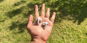

Why Does One AirPod Die Faster Than the Other?
417 viewsHeadphones
5 Answers
AirPods operate through synchronized components with varying battery impacts, leading to uneven drain. Key causes include:
Microphone Role & Single-Ear Usage
When removed from the case, one AirPod automatically becomes the primary microphone (processing voice input), while the other functions solely as a speaker. The microphone-enabled unit consumes more power, accelerating its drain. Frequent single-ear use further strains that unit’s battery through additional charge cycles.
Irregular Charging Patterns
Repeatedly using one AirPod while the other remains in the case creates inconsistent charging cycles. Poor contact with the charging case’s metal connectors (e.g., due to debris or misalignment) may also prevent one unit from charging fully, exacerbating imbalance over time.
Physical Damage or Moisture Exposure
Liquid ingress can corrode internal circuits or battery components, causing abnormal discharge. Signs include rust on charging contacts or distorted sound. Physical impacts may damage battery circuitry, leading to accelerated degradation in one unit.
If you’ve ever found yourself asking why one AirPod runs out of juice faster than the other, you’re not alone. Despite being designed identically, AirPods sometimes act like siblings with different habits. One might drain its battery quicker than its twin for several reasons. Let’s dive into it:
Usage Habits
  • Uneven usage: If you often use one AirPod by itself to stay aware of your surroundings or for convenience, you might be wearing it out faster. It’s like favoring one sneaker over the other; the favored one will get more wear and tear. For instance, if you always pop in the right AirPod for calls and only use the left one when you need stereo sound, the right AirPod is going to get beat up a lot faster. A simple fix is to switch it up now and then—give both sides equal playtime.
  • Microphone usage: Your AirPods default to using the mic in the first earbud you stick in your ear. So, if you always put the same one in first, it’s doing the heavy lifting, battery-wise, for calls and Siri. Mix things up by changing the setting on your phone. Head to Settings > Bluetooth, tap the “i” next to your AirPods, and set the mic to switch automatically.
Hardware Issues
  • Charging case problems: If one side of your charging case is messed up or full of gunk, that AirPod might not charge properly, causing it to die faster. Regularly clean out the case and AirPods with a dry cotton swab. If there’s real damage, you might need to hit up Apple Support.
  • Battery degradation: Those tiny batteries don’t last forever. Over time, the power each AirPod can hold decreases just from regular use, which can make one die faster than the other. If both your AirPods are suffering, Apple’s Battery Service can hook you up with a replacement.
  • Defective earbuds: Sometimes, it’s not you, it’s them. Every once in a while, a defective AirPod slips through quality control and will always drain faster. If you’re still under warranty, get in touch with Apple Support to see if you can get a replacement.
Software Settings
  • Outdated firmware: Running old firmware can mess with your battery life. AirPods should update automatically, but it’s worth checking. Go to Settings > Bluetooth, tap the “i” next to your AirPods, and verify the firmware version. If there’s an update, just keep your AirPods in their case, plug it in, and keep it near your iPhone to update.
  • Double-tap gestures: Using double-tap gestures like skipping tracks or activating Siri can burn through the battery faster on one side if you’re always tapping the same one. You can spread the love by assigning gestures to both earbuds or even turning them off. Go to Settings, select your AirPods, and tweak the double-tap settings.
Usage Environment: Using AirPods in extreme temperatures, whether it’s hot or cold, can mess with the battery and cause uneven drain. Keep them in mild conditions as much as possible to make them last longer.
Solutions
  • Fully drain and recharge: Occasionally let both AirPods completely run out of battery and then charge them fully. This can help recalibrate them a bit.
  • Reset AirPods: Forget your AirPods on your iPhone and then set them up again.
  • Replace AirPods: If nothing else works and one AirPod continues to die fast, it may be time for a replacement.
To avoid the one-dying-faster scenario, mix up your usage, keep them clean, update your firmware, and use them in ideal temperatures. And if all else fails, Apple Support is your friend.
