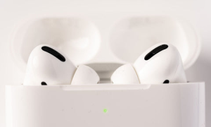

If your AirPods case is blinking green and refuses to connect, this typically signals that the charging case cannot detect one or both AirPods, often due to charging misalignment, low battery, software glitches, or pairing conflicts. Below is a common causes and solutions:
Possible Causes of Green Blinking Light
Charging-related issues‌: One or both AirPods may not be seated properly in the case, or their batteries could be completely drained, preventing detection.
Software issues‌: Outdated firmware on your AirPods or connected device (e.g., iPhone, Mac) can disrupt connectivity.
Pairing conflicts‌: Wireless interference or corrupted Bluetooth settings may cause pairing failures.
Step-by-Step Troubleshooting Guide
Charge the AirPods properly‌:
Place both AirPods securely in the case and connect it to a power source (via cable or wireless charger). Ensure the charging indicator turns solid green within a few minutes, confirming adequate power. If the light remains blinking, check for debris or improper positioning.
Update your device software‌:
On Apple devices, go to Settings > General > Software Update to install the latest iOS, iPadOS, or macOS version. This resolves bugs affecting AirPods connectivity.
Reset and re-pair your AirPods‌:
Close the case lid for 30 seconds, then reopen it. On your iPhone or iPad, navigate to Settings > Bluetooth, tap the “i” icon next to your AirPods, and select “Forget This Device”. With the case open and AirPods inside, press and hold the setup button on the back until the status light flashes amber, then white (about 10–15 seconds).Reconnect by bringing the case near your device and following on-screen prompts.
If the issue persists after these steps, it may indicate hardware problems like battery degradation; consult Apple Support for diagnostics or replacement.
